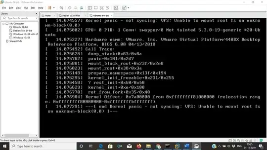

Then while I posted this question here I some how was able to restart the system and now I get
end kernel panic not syncing :VFS: Unable to mount root fs on unknown block (0,0)
kernel panic unable to mount root on unknown block 0,0 Here is a video for the same. Now I don't know what should I do. Why this problem came. How to debug this and fix this. Rather than creating a new VM by downloading a new ISO I am more interested to learn and fix the problem which has caused this.

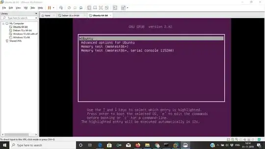

After a long struggle I have been able to fix this with the help of previous answers and trial and errors. I booted into Advanced mode while booting Ubuntu press F2 when you see grub2 bootloader. On some systems you may need to press Shift to get to advanced boot menu.
In my case since I was in a VMware Workstation environment I pressed Shift or F2 to get to boot menu as shown below
which kernel to boot
So now you see many kernels are shown I started selecting one by one.One kernel after other and tried booting in some cases I failed and I got the same error message saying kernel panic vfs unable to mount root filesystem could not find (0,0)
The kernel that worked in my case from above entries was
5.0.0-32-generic

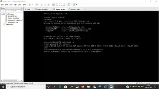

key will give you required command prompt login. Then login with your username and password. I was logged into tty6 (Ctrl+Alt+Fn+F6)
logged in to tty6
As explained on answer here:
update-initramfs -u -k 5.3.0-19-generic (or your version)

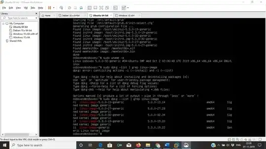

If you don't know your version. Use:
dpkg --list | grep linux-image
And just update Grub:
update-grub2
But just this grub update won't work as grub still is not there on hard disk. I am uploading screenshots in my case this command failed also at one or two kernels
generating initramfs
dpkg --list | grep linux-image:

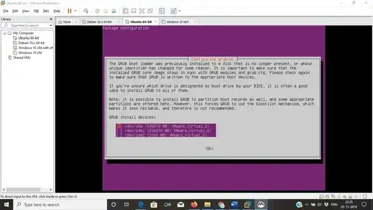

Now without logging in GUI and before a reboot (after doing update-grub2) I did a
dpkg --configure -a
I got following screenshot during grub upgrade
grub update and re install message
As mentioned in this answer https://askubuntu.com/a/939883/992730 press space to select the desired entry and arrow keys to move up and down. Now you see even after a update-grub2 command dpkg --configure -a was required.

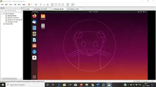

Then after a reboot I was able to get back a working system 19.10
finally working 19.10
Here I was finally successful.
