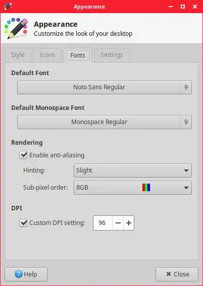

What I did before XFCE 4.14
This seems to work for < 4.14 and for >= 4.14 the same way:
Custom DPI settings in Appearance -> Fonts allows changing scaling of windows for both monitors at the same time:
screenshot
This works only for one screen unfortunately. The best I could come up with is adding this script as shortcut to toggle between different settings:

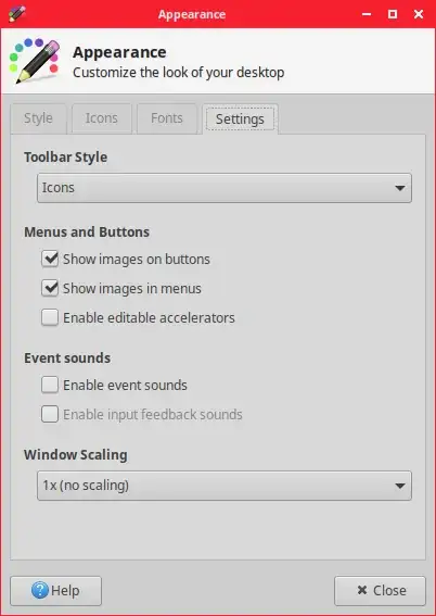

What is new but doesn't help
I think the Window scaling option is new (but I'm not sure), but it offers only 1x or 2x scaling for both screens at the same time. This is not helping in my situation.
screenshot

You could try combining 2x Windows Scaling and xrandr --output eDP-1 --scale 1.25x1.25 to get less upscaling. It might affect to graphics performance, when e.g. playing videos, though. At least you can make the setting xrandr setting for each monitor separately.
