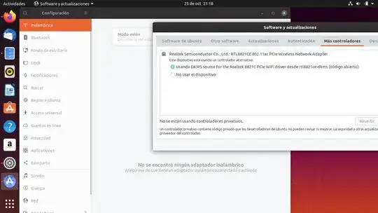

I was using ubuntu 19.10 and I had to install this Wi-Fi driver following instructions:
How to install Wi-Fi driver for Realtek RTL8821CE on Ubuntu 18.04?
However after an update applied and restart it just stopped working
I searched on additional drivers and this was disabled
I tried to re-enable it but nothing happened
How can I make them work back?
