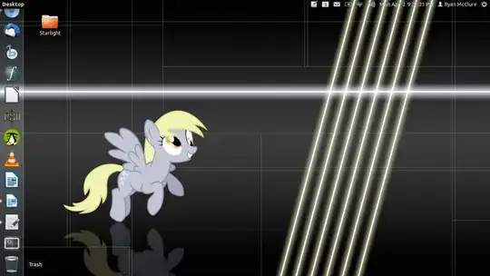

Whenever I open a program from Libreoffice3.5, it will open with its own launcher icon. For example, if I click on my docked "Writer", it will open in another icon.
I've also noticed that these opened icons are very blurry too... Any one have a solution?
