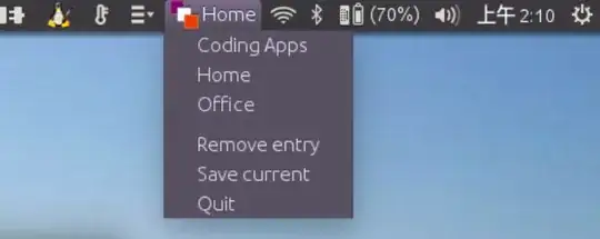

Disclaimer: I am the original author of this indicator.
The Launcher List Indicator has been developed specifically for the purpose of having more than one set of icons on the Unity launcher and allow easy switching between them.
How does it work
Suppose you want to have a launcher list for home use, another for work apps, another for something else.
Here's the steps:
  1. Start by adding all the icons you want to have in Home profile.
  2. Once you're satisfied with that list, click Save current in the indicator, and you will have a popup dialog appear asking you to name the profile. Click OK, and you will see that profile to be added to the list.
  3. Clear the launcher and repeat the process to add another profile. Very simple, very minimalistic , very easy to use.
Obtaining the Indicator
The simplest method is to download zip archive from the project's github page :
 https://github.com/SergKolo/launcher-list-indicator/archive/master.zip
If you have git installed, you can obtain latest version via command
git clone https://github.com/SergKolo/launcher-list-indicator.git
It is intended to be started as part of Startup Applications upon user login.
It is recommended to keep the app and its icon in the same folder

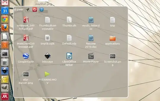

Check out a new application: Drawers
http://www.iloveubuntu.net/how-easily-group-items-featuring-their-own-mini-dash-unity-launcher-drawers
http://www.iloveubuntu.net/create-bundles-files-and-folders-unity-launcher-fancy-drawers-ppa-available
you can add the ppa by doing
sudo add-apt-repository ppa:ian-berke/ppa-drawers
sudo apt-get update && sudo apt-get install drawers
Just type Drawers into the Dash to get started. It'll create a drawer launcher in ~/.local/share/applications which you can place on the launcher/dock. Then drag and drop anything you want to it (documents, folders, applications, web-urls). Left-Clicking opens up a mini-dash with icons for each file, while right-clicking opens up a quicklist. Right clicking items in the open drawer allows you to edit their name or execution command. Left clicking launches them with their default application.
Ian B.

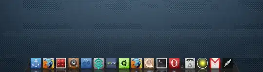

if I decide to stick my frequently used apps in the launcher, then, 3 or 4 launchers would not be enough. Yet, if you want to break the Unity experience and see yourself not using the dashboard anyway, use DOCKY as a secondary launcher: http://wiki.go-docky.com/index.php?title=Screenshots
DOCKY
