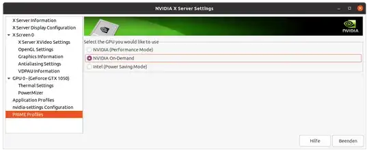

Nvidia drivers only on-demand
Set the 'on-demand' option in the Nvidia GUI: "Nvidia X Server Settings" -> "PRIME Profiles": NVIDIA On-Demand
