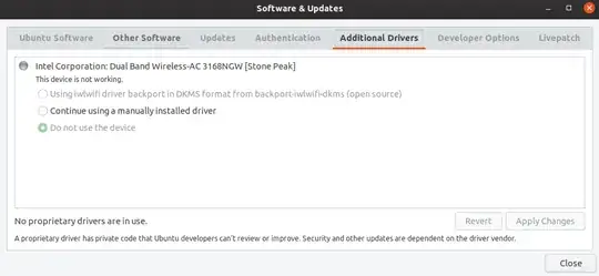

The additional drivers panel in Software & Updates shows the "device is not working", however, it has always said this. This has not changed. Though I am unable to make any selection here as the buttons are greyed out.

Drivers panel:
The Firmware files are present in /lib/firmware, I didn't manually install these: iwlwifi-3168-21.ucode, iwlwifi-3168-22.ucode, iwlwifi-3168-27.ucode, iwlwifi-3168-29.ucode

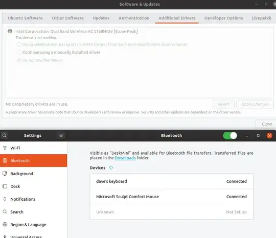

Found the answer in another thread: Bluetooth not working at all after I made some changes to pair with PS3 joystick
Turn off the computer, unplug everything including power, give it a few minutes and then power back up. Bluetooth is back again. (I had tried powering off, and rebooting, but not disconnecting everything)
You can see in the screenshot that it is still acting strange in the Additional Drivers panel, but that Bluetooth devices are successfully connected:
