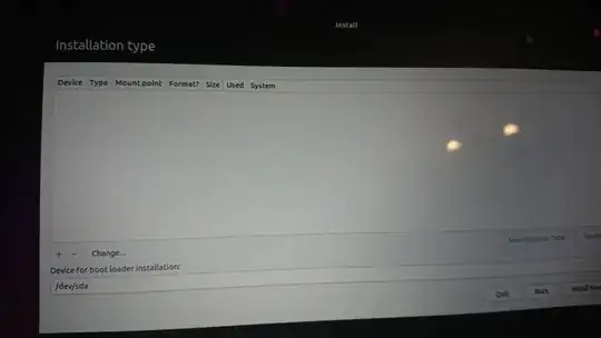

I'm attempting to install Ubuntu 19.04 on a 2019 Dell Inspiron 7490 (service manual). When I get to the point of selecting a partition to install on, the installer can't find any hard drive and I just see an empty list like this:
here.

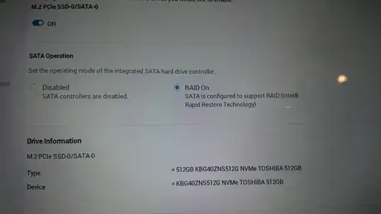

Although its a bit outdated. They suggest to first set the SATA operation to AHCI in BIOS. In my BIOS I don't get an option for AHCI as seen below:
here
Only disabled or RAID. To my understanding, AHCI is a type of RAID so maybe this is the correct setting. Thoughts?

AHCI is not a form of RAID; it adds capabilities in communicating to a SATA drive, but not RAID.
Until the drives appear in the BIOS/firmware setup, nothing you do will work in any OS. This is a firmware issue specific to this model of Dell, so I would ask Dell Support to get the drive to appear in BIOS/firmware setup.
