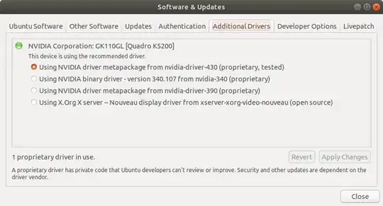

I've installed the recommended NVIDIA proprietary drivers:
Software & Updates Screenshot

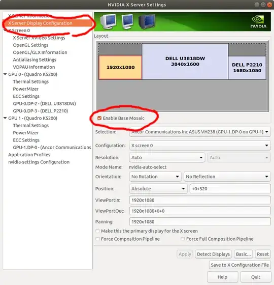

One more follow-up -
After removing the NVIDIA drivers, I was struggling with 3D acceleration issues (Blender kept locking up my entire system), so I kept plugging away on this issue.
In the end, I re-installed the same recommended driver and then was looking in NVIDIA X Server Settings. Under the X Server Display Configuration section, there is a checkbox labeled "Enable Base Mosaic" which was not checked. Upon selecting that box, applying the config change, saving out to my X Configuration file, and rebooting, it started working. I'm not entirely sure what Base Mosaic is, but I'm now running proprietary drivers with three monitors.
Screenshot
