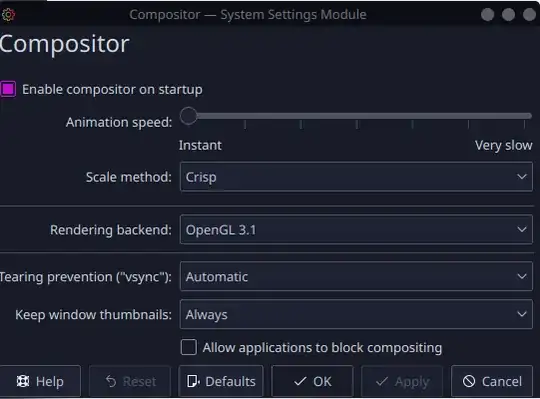

I have this same issue on 19.10 with latest Kubuntu and i915 driver for Intel GPU.
I think I got it working with these settings: settings
Operating System: Kubuntu 19.10 KDE Plasma Version: 5.16.5 KDE Frameworks Version: 5.62.0 Qt Version: 5.12.4 Kernel Version: 5.3.2-050302-generic
