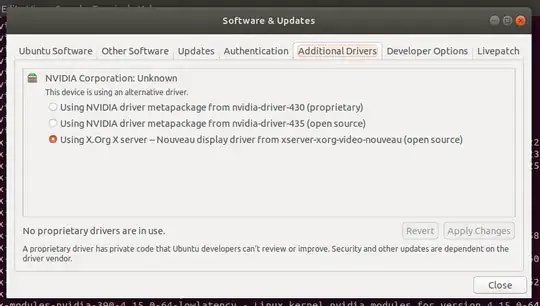

This what Additional Drivers shows before installing the drivers:
additional driver before install

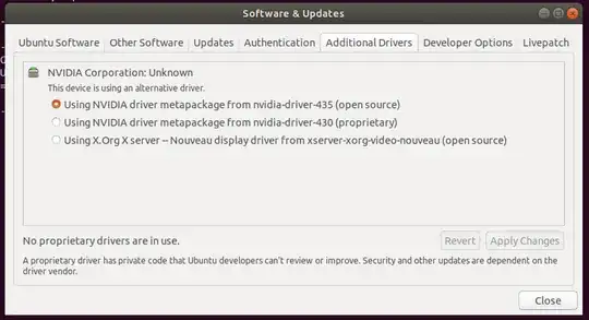

This what Additional Drivers shows after installing the drivers:
additional driver after install

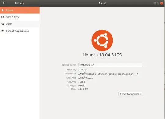

This is the About info regarding the machine:
about the machine

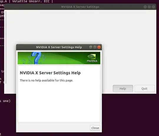

shivakumaar@techpack-tuf:~$ nvidia-settings
ERROR: Unable to load info from any available system
(nvidia-settings:2313): GLib-GObject-CRITICAL **: 13:01:50.443: g_object_unref: assertion 'G_IS_OBJECT (object)' failed
** Message: 13:01:50.448: PRIME: No offloading required. Abort
** Message: 13:01:50.448: PRIME: is it supported? no
nvida x controller settings
