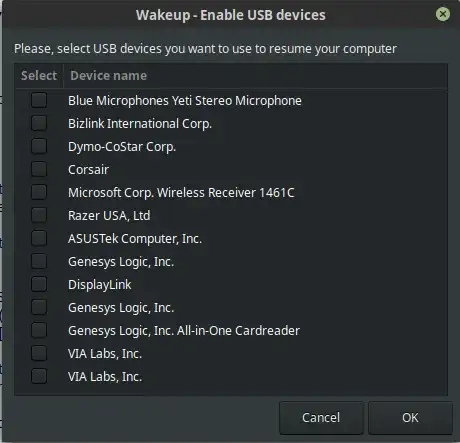

The computer will suspend for a matter of seconds, then without touching anything on my mouse, nor moving it and not touching my keyboard it will wake itself up.
I have tried using: cat /usr/local/sbin/select-resume-devices
Which looks like, I select microftsoft keyboard and save. It makes no difference:

What my wakeup looks like
