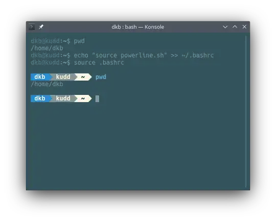

For Kubuntu 19.04, install fonts-powerline using sudo apt install fonts-powerline. Your system should also have fonts-hack.
Visit this site and copy the entire script, all 348 lines as on 20190906, to ~/bin and save it as powerline.sh or whatever. Use the file manager to make the script executable.
(Note that ~/bin is by default in your system's path and so you do not need something like $HOME/bin/.powerline.sh.)
Open konsole and, from your home folder, run
echo "source powerline.sh" >> ~/.bashrc
Doing so will add
source powerline.sh
as the last line of your ~/.bashrc.
From your still open konsole window, run
source .bashrc
to reload .bashrc and use powerline.sh in the existing konsole window.
If you want to go back to the default prompt, comment out the source powerline.sh line in ~/.bashrc by placing a # mark at the beginning of the line.
Read the contents of ~/bin/powerline.sh if you want to modify some aspects of the prompt.
konsole prompt using powerline fonts
Konsole, whether in Kubuntu 19.04 or Kubuntu 18.04, doesn't need fonts-powerline installed. But other terminals such as lxterminal and gnome-terminal need the package to get the triangles and the prompt to display nicely.

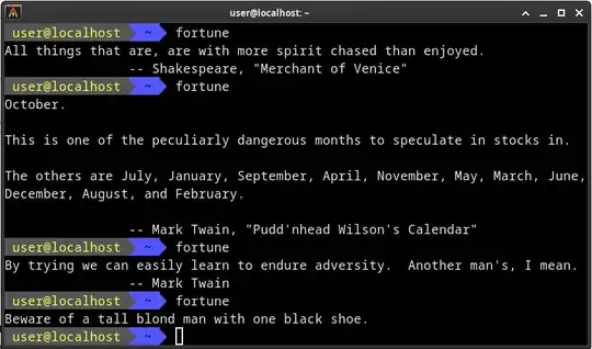

Here's one solution – it creates a two‐segment graphical prompt using standard ANSI escape sequences and Unicode escapes (so no literal arrow character). This version uses your updated first segment color (light yellow on dark gray) and the second segment as before. Add this to your ~/.bashrc and reload your shell:
# Set terminal title (optional)
PS1="\[\e]0;\u@\h: \w\a\]"
Segment 1: Dark Gray background (100) with Light Yellow text (93)
PS1+=$'[\e[100;93m] \u@\h '
Arrow from Segment 1 → Segment 2:
Arrow’s foreground is set to dark gray as a foreground (90)
Arrow’s background is set to Light Blue (104)
PS1+=$'[\e[90;104m]\uE0B0'
Segment 2: Light Blue background (104) with Black text (30)
PS1+=$'[\e[104;30m] \w '
Arrow from Segment 2 → default background:
Arrow’s foreground is bright blue (94) and background resets to default (49)
PS1+=$'[\e[94;49m]\uE0B0'
Reset formatting (no trailing prompt symbol)
PS1+=$'[\e[0m] '
Make sure your terminal is using a font that supports the Unicode code point U+E0B0. This prompt works in any Bash session.

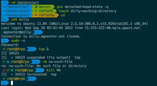

The simplest way: https://ohmyz.sh/
And choose a theme like this one: https://github.com/robbyrussell/oh-my-zsh/wiki/Themes#agnoster
