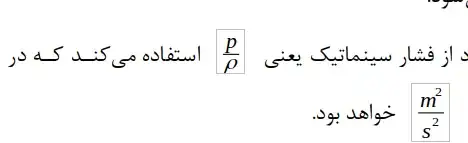

I have this in odt:

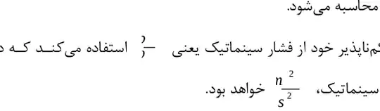

When exporting as pdf from libre writer, I end up with:
As you can see, the parts that I put them using insert -> formula, disappears partially. Why?

It seems that this happens when (the computer's memory is less* and) the document has large number of formulas [1].
A workaround would be to increase the cache size of OLE objects, i.e. go to Tools > Advanced > Open Expert Configuration and increase the value of "org.openoffice.Office.Common/Cache/Writer/Writer" from 20 (default) to a value of 600 [1, 2].
To be sure, restart LO writer after saving the above change.
References
  1. https://bugs.documentfoundation.org/show_bug.cgi?id=99225#c56
  2. https://bugs.documentfoundation.org/show_bug.cgi?id=99225#c19
*I increased my laptop's RAM from 3GB to 6GB and, in spite of this, the problem persisted. So I am unsure as to how much RAM is "less" RAM. Thankfully the workaround seems to work.
