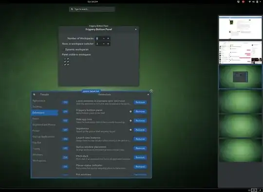

Two benefits over Frippery Bottom Panel (which work well, cf. this answer) are:
  1. No hacking required to remove the bottom panel.
  2. In the overview, the grid structure is shown as the chosen two-dimensional grid. With Frippery Bottom Panel, The overview continues to shows a single strip of workspaces.

Frippery Bottom Panel. Though a workplace grid is achieved, it is not shown in the overview. Frippery Bottom Panel extension

For 3.10 - 3.20: Go to extensions.gnome.org and find Frippery Bottom Panel. Install it. This will give you a bottom bar. Clicking on the right side will give you an option to disable dynamic workspaces and allows you to set number of rows and columns.
