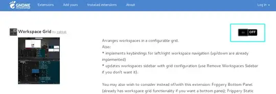

The option to install GNOME extensions using GNOME Tweaks is removed from last few versions of the application. But you can simply install and manage extensions from their official websites. To do that first install the chrome-gnome-shell package by running the following command in Terminal
sudo apt install chrome-gnome-shell
Then visit https://extensions.gnome.org/ using Firefox or Google Chrome, the website should ask you to install one browser add-on/extension. Install it.
Then go to the extension's homepage, you'll be able to install the extension just by toggling on the button at the top-right:

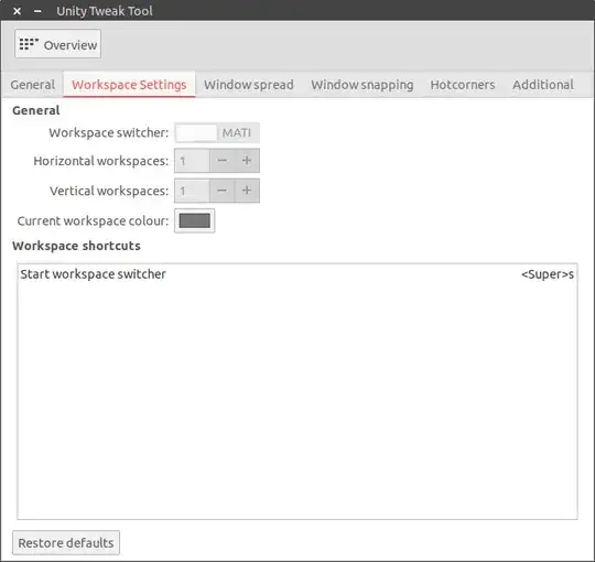

You can install Unity desktop if you don't mind downloading and using other than GNOME desktop. It's pulled back to universe repository (unlike 16.04 which is in main), which Canonical doesn't maintain anymore.
Simply type this command in terminal:
$ sudo apt install ubuntu-unity-desktop unity-tweak-tool
You might be prompted with choices of default desktop manager. Pick either gdm or lightdm.
Log off/reboot and select Unity when logging in. Then, open Unity Tweak Tool and click Workspace Settings.
Here, you can configure it to have 2 by 2 workspaces.
