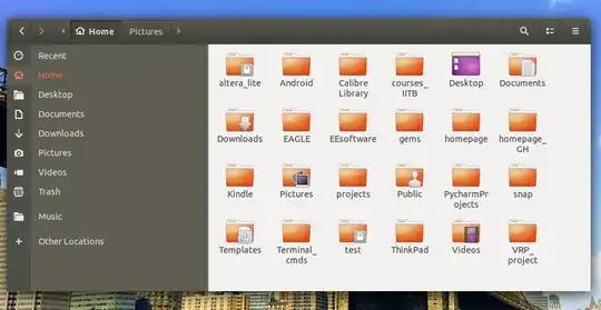

Since upgrading to Ubuntu 18.04 from Ubuntu 16.04, the titlebar buttons on the upper left corner of the window for closing, minimizing and maximizing windows have vanished.
