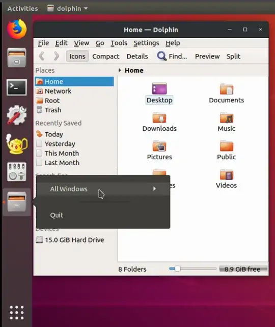

Dolphin (shown below), gwenview and kate don't show an "Add to Favorites" option
dolphin

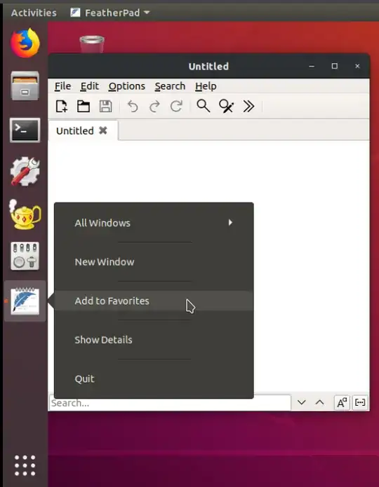

Featherpad (shown below) and qterminal have the expected "Add to Favorites" option
featherpad
