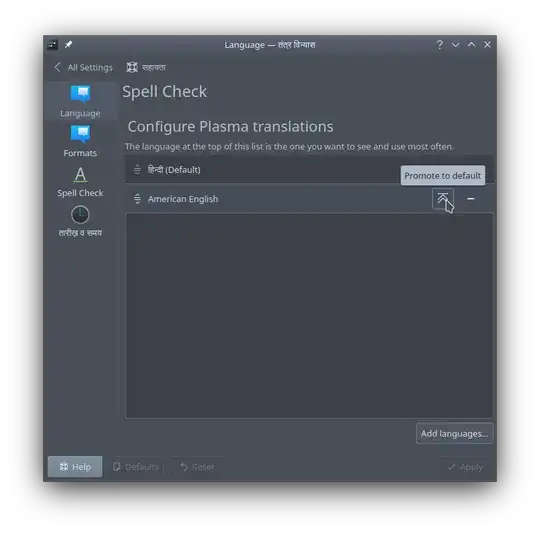

When I opened System Settings > Regional Settings > Language for the first time, no languages were listed under Configure Plasma Translations. So I first added American English and then added Hindi. I tried to add Marathi as the third language and that caused a System Settings crash. So I stayed with just the two languages.

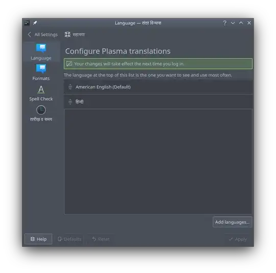

To switch languages, click on the row listing the language you want and then bring it to the top as shown:
The change of language needs a log out:
As you can see, the translations are partial. The translation team would appreciate help in this respect if you have the time to spare.
