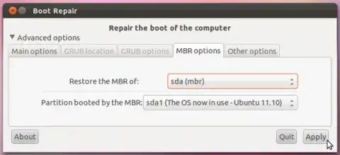

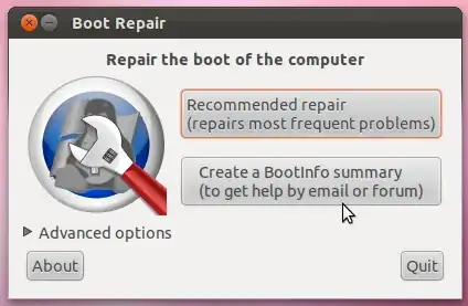

Boot into a live CD and run this
sudo add-apt-repository ppa:yannubuntu/boot-repair && sudo apt-get update
sudo apt-get install -y boot-repair && boot-repair
Install Use the Advanced options
To start using gksudo boot-repair
source
