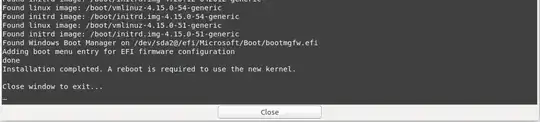

I installed the kernel with ukuu. There was something mentioned with EFI. May this be the cause?
