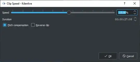

With Kdenlive 20.08, you can right-click the clip in the timeline -> Change Speed. In the dialog choose the speed ratio, and check Pitch compensation.
Change Speed Dialog
