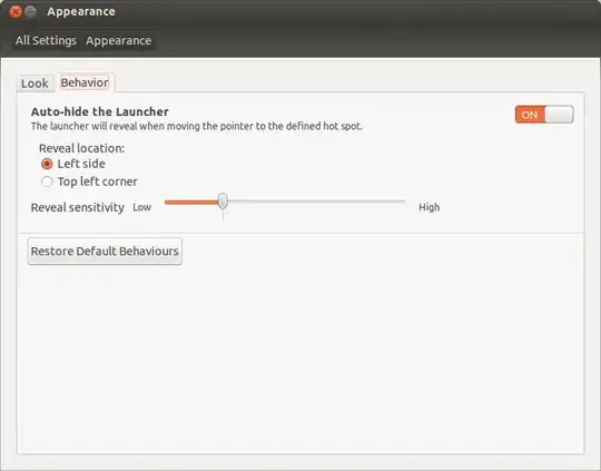

12.04 official release allows auto-hide of the unity panel.
Open System Settings and click on Appearance and select the Behavior tab to adjust the settings.
