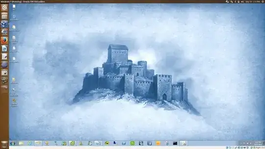

I just updated to VirtualBox 4.3.16 and now when putting my guest OS in fullscreen the Unity launcher stays over the top of the screen. This makes using full screen unworkable.
Does anyone have a suggestion to fix this issue?
