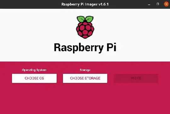

Open the terminal and type:
sudo snap install rpi-imager

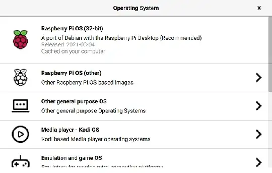

Once this is done, start the Imager and open the CHOOSE OS menu.
Scroll down the menu click Other general-purpose OS.

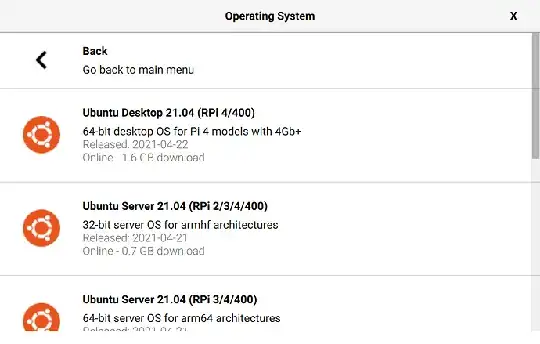

Here you you can select Ubuntu and see a list of download options. For this tutorial we recommend you select the Ubuntu 20.04 download. Note: Some of the operating system download options shown in the above Operating System menu may be obsolete because those download options have been discontinued. As indicated in the imager this will work for the Raspberry Pi 2,3, 3+ and any of the 4's.
Select the image and open the SD Card menu. Select the microSD card you have inserted. Finally, click WRITE and wait for the magic to happen. This might take a few minutes.
Now you have your Ubuntu SD card. Before going on, make sure your Pi is off and insert this SD card. This is what the Pi uses to load all the software you're about to use.
