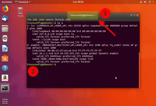

I've been reading about this topis here and tried the solution given to change the terminal name (refer to the picture on item number 1)
But none of them can change the terminal's name (item number 1).
user@linux:~$ gnome-terminal --title="SOME TITLE HERE"
user@linux:~$
user@linux:~$ PROMPT_COMMAND='echo -ne "\033]0;SOME TITLE HERE\007"'
user@linux:~$
user@linux:~$ echo -ne "\033]0;SOME TITLE HERE\007"
user@linux:~$
I know that item number 2 can be changed with PS1. But the title (item number 1) still didn't change even after I change the PS1
user@linux:~$ is fine. I don't want to change this, I just want to rename the terminal's title on the top (item number 1)

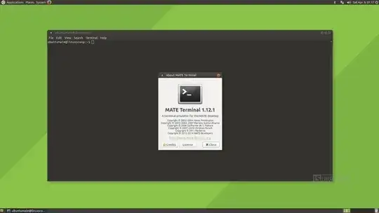

The Gnome 2 terminal has been forked as mate-terminal bundled in Ubuntu Mate. The title option is still available with this version
sudo apt-get install mate-terminal

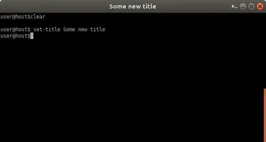

With Gnome Terminal, a way to set the window title will be to play with PS1
You can add a function to your .bashrc file an call it to change the Window/Tab title
nano ~/.bashrc
Add the function
function set-title() {
  if [[ -z "$ORIG" ]]; then
    ORIG=$PS1
  fi
  TITLE="\[\e]2;$*\a\]"
  PS1=${ORIG}${TITLE}
source ~/.bashrc to reload
set-title Some new title to change the Window/Tab title
Limitation: when a program changes the PS1, the title may change too (example: ssh to another host will reset the custom title)
