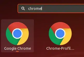

Now I have 2 Chrome icons in Applications:

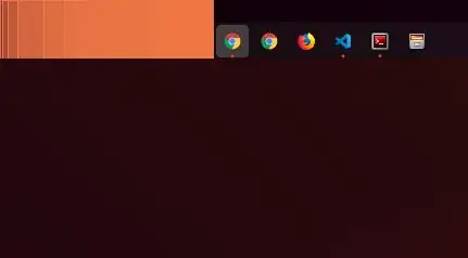

and I can indeed drag&drop the newly created Chrome to my launcher:
The problem is, when I click it, or do super+2 in keyboard, it opens a new window but binds it to the first dock item, so I get two Chrome instances on the first item, and nothing on the second one:

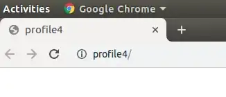

strong textThings tried: adding StartupWmClass=Profile4 and Exec=google-chrome --profile-directory=Profile\ 4 --class Profile4 as mentioned in the comments. the result is still opening the windows under the first chrome dock item, and displaying this:
