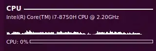

UPDATE
It appears that my CPU has minimal usage and the laptop still heats up
It clocks at 1.8 to 2.2 GHz, with max freq at 4.1 GHZ, yet I cant seem to find the source for it heating up.
