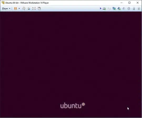

Just today when I started Ubuntu 18.04 (Linux Kernel 4.15.0-51) in VMware Workstation Player 14 (14.1.7) the boot freezes just before the login prompt. The mouse cursor is visible and the Ubuntu logo at the bottom center is just being rendered as is visible in the attached screenshot. (Depending on the exact moment of the freeze the Ubuntu logo appears more or less bright.)

Boot freeze on purple screen before login prompt:
