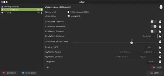

There is no need to compile anything. The necessary software is already in Ubuntu since at least focal, either Solaar which seems to be the most popular or logiops as an alternative. Both can be installed the usual way.
sudo apt install solaar
sudo apt install logiops
It has been my experience with Logitech input devices that the general configuration tools in Ubuntu have the problems you describe in that either no satisfactory setting can be found or that configurations are lost randomly, often after a reboot. Furthermore, at least Solaar allows a much more fine-grained configuration than the generic tools. I guess it's not by accident that these pieces of software were written, to unlock the full power of the Logitech hardware on Linux.
Here is a screenshot of some of the configuration options available in Solaar. In your case, the one I would try is Sensitivity (DPI). Setting higher values here made the mouse travel faster and farther for me, lower values made for shorter and more precise movements. I hope it works for you, too.
