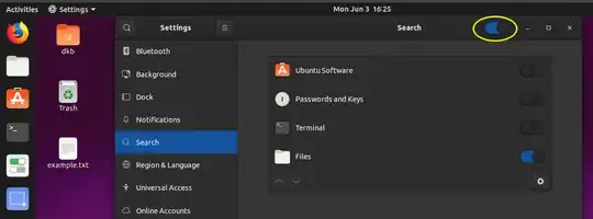

The ability to star files requires you to have "Search" (which uses Tracker) active. "Search" is enabled via the Settings icon in your launcher (and not from Nautilus):
Enable Search

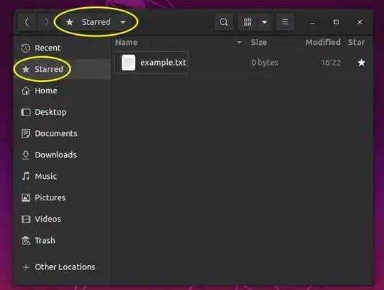

And by clicking on the star icon, you can list starred files:
List starred files

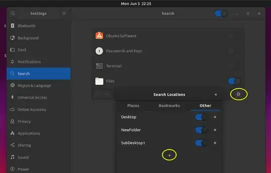

How to add folders so that they can be tracked and starred:
In the image below, in Settings > Search clicking on the little ⚙ (gear) icon opens a new window titled "Search Locations" to allow you to add additional folders. Click on the + icon to get a list of folders you can include.
I found a reboot helpful in getting those new folders to be registered properly.

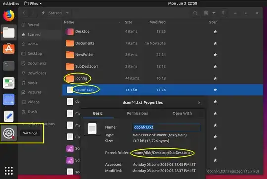

And here is an image showing various folders and files I've added and starred.
  • ~/.config folder is starred
  • a folder, SubDesktop1, within ~/Desktop is starred
  • a file, dconf1.txt, within ~/Desktop/SubDesktop1 is starred as can be seen from the Properties window.
  • for me, it appears that a reboot is needed when a "non-standard" folder is to be starred (and tracked).
Image showing additional folders and files starred
