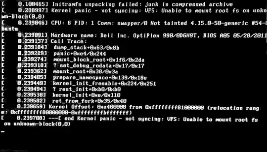

I updated Ubuntu, and upon reboot I got this error screen:
Things I've tried so far:
  • Boot Repair from Ubuntu Live on USB; no change; booting into various recovery modes doesn't help, either.
  • Memtest for about 90 minutes, revealed no errors.
  • Replacing RAM entirely; still no difference.
I'm not afraid of the command line, but I don't have an advanced understanding of Ubuntu.

Since you can't boot into Recovery Mode, to fsck your file system...
  • boot to a Ubuntu Live DVD/USB
  • open a terminal window
  • type sudo fdisk -l
  • identify the /dev/XXXX device name for your "Linux Filesystem"
  • type sudo fsck -f /dev/XXXX # replacing XXXX with the number you found earlier
  • repeat the fsck command if there were errors
  • type reboot
Update #1:
  • fsck on /dev/sda2 was fine
  • the computer has both -48 and -50 kernels, and it won't boot from either
  • we updated the initrd.img file for -50, no help
  • the initrd.img for the -48 kernel is from May 18th, so it should boot
    • -rw-r--r-- 1 root root 38477701 May 18 10:37 initrd.img-4.15.0-48-generic
  • two choices:
    • update the BIOS from A05 from 2011, to A20 from 2017
    • backup important Ubuntu files and reinstall Ubuntu
Update #2:
  • the BIOS update to A20 did not fix the problem
Update #3:
  • Ubuntu was reinstalled
  • However it installed the incorrect version of GRUB, and it wouldn't boot
  • boot-repair solved the problem by installing the correct version of GRUB
  • user should check BIOS settings are UEFI, and then wipe the disk, and reinstall Ubuntu
