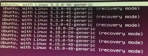

I install updates regularly, but for months now, after updating and rebooting, my computer will only boot if I select one of the Linux 4.x kernels in the GRUB options. The 5.x kernels present
Loading [version number] ...
error: invalid magic number.
Loading initial ramdisk ...
error: you need to load the kernel first.
The error occurs for both the regular and "recovery mode" entries.

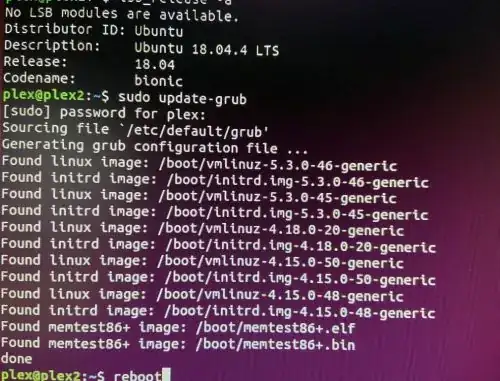

I've run GRUB repair, and sudo update-grub. When I update GRUB, it confirms that it's finding all the Linux images:
But I can still only boot into the 4.x kernels.
