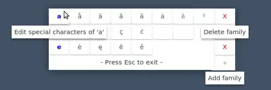

If you are not afraid to set up (instructions should be clear), below could give you an alternative to quickly insert your often used special character (-alternatives).
Editable special character tool
The script below is a flexible tool (window to insert characters from, in a click) to have often used characters available in a second:
How it works
  • Call the window with a shortcut
  • To insert a character, simply click on it, and it will paste the character into the window you were working in.
  • To add a set of characters, press + A text editor window will open, add your "family" name on the first line, related special characters on the next lines, one character per line, for example:
    a
    å
    ä
    ã
    â
    á
    à
    ª
    (from the image). Close the file, the special characters will be available from now on from the next time you call the window.
  • to delete a set of available characters, press x

  3. Set up a shortcut key to run:
    python3 /path/to/specialchars.py
On first run, you will only see a + button. Start Adding your character "families" and restart (-call) the window to have all available in a click.
That's it...
