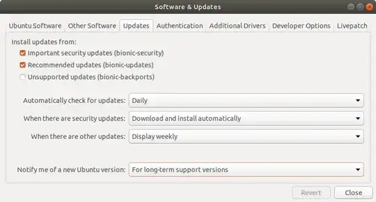

Check if The standard Ubuntu Software application can be run and go to the updates section. You can select many software sources here. Select all sources and newer versions and apply. Then try updating again. If you cant even update an upgrade is unlikely too. Try this first. enter image description here
