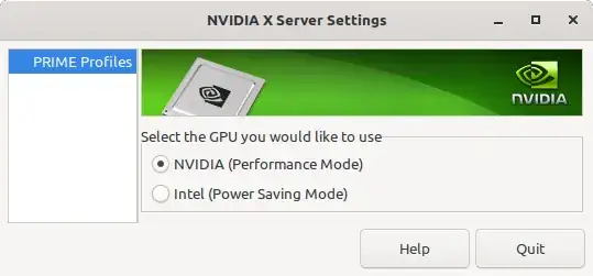

And the nvidia-settings command just displays a simple window like this:
Considering all these, I believe that currently the Intel graphics card, and not the NVIDIA graphics card is active in my system.

Your reported symptoms exactly match the case of having an installed Nvidia driver, but logging in with wayland. At the login screen, click on the little gear next to the signin button, and select a non-wayland choice. Proceed to login, and the nvidia-settings should be fully functional.
