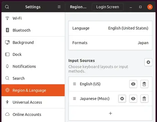

I want to modify the Mozc settings.
Problem: Clicking the gear at the right of Japanese (Mozc) has no effect:
On previous versions of Ubuntu, a workaround was to run /usr/lib/mozc/mozc_tool --mode=config_dialog from command line, but that executable does not exist anymore (the mozc_server and mozc_renderer in the same folder do not seem to do anything when run with the same argument).
Is there a workaround to open the Mozc settings? They are supposed to look like this:

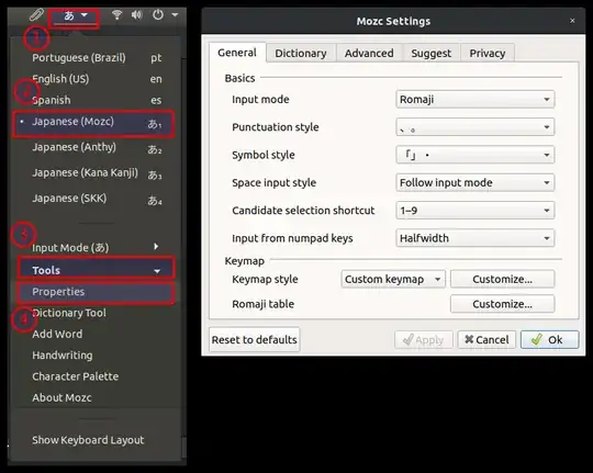

Ubuntu (18.04) uses IBUS to be the IMF (Input method framework). And it manages the IMEs (Input Method Editor), like MOZC.
Install:
  • ibus: sudo apt install ibus.
  • mozc: sudo apt install ibus-mozc mozc-utils-gui.
Navigation
To see the configuration window:
  1. Click on Gnome Status menu (Gnome's top-left bar) > IBus menu (i.e. keyboard/input language selector) > Select Japanese Mozc input method.
  2. Again, click on Gnome Status Menu > IBuz > tools > Properties > Mozc Settings window.
Screenshots
ibus-mozc
