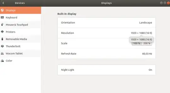

I recently bought a Dell XPS 9380, I installed Ubuntu 18, everything is perfect, I only have one problem: I would like to lower the resolution of the laptop screen because I have a large monitor and it ends up being disproportionate, the only option I have is' 1920x1080.
I'd like to know how to enable low level solutions.
screenshot
