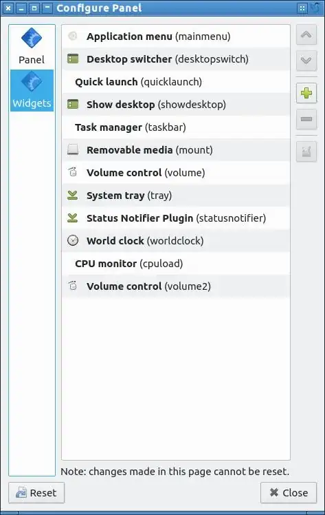

Right click on panel, go to Configure Panel and ensure you have "Quick Launch" widget enabled, then drag/drop menu items to the Quick Launch panel widget. Worry about the order of the dropped programs after adding them (you can move left-right then)
