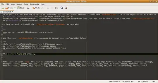

then restart Pluma and enjoy:
Markdown is highlighted in Pluma 1.12.2
