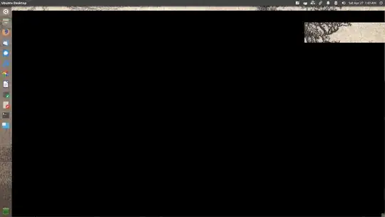

The Lock Super+L option appears in the system menu as normal, but it doesn't do anything (nor does hitting those keys). The system is set to show the lock screen upon waking up from suspend, but it no longer does so, it just immediately shows the desktop (well, a black box and the desktop, see the picture below).

I should also add that when the computer wakes from suspend, there's a black area that appears, which only becomes clear when a opening a window or something refreshes the screen.Ugly Disabling asking for password when waking from suspend in the system settings prevents the black screen from showing up, but, of course, that doesn't give me a screen lock.
