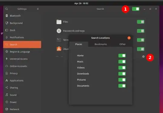

A graphical interface present in early versions of tracker has been removed in more recent versions, but going into Settings > Search provides an on/off switch (1 in the image below), as well as an interface to choose which folders are to be indexed (the little cog wheel icon next to 2 in the image below).
Turning Tracker on/off or adjusting its settings
Tracker: System Settings > Search
