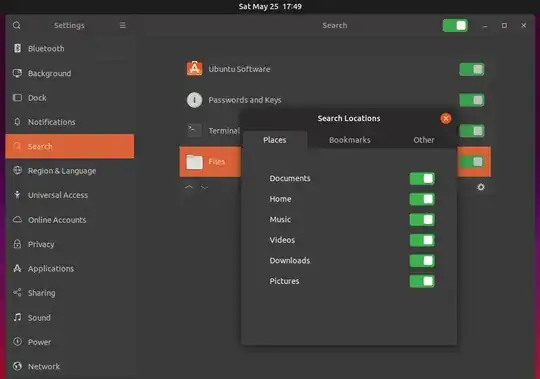

I suggest that immediately after you login, open the Settings > Search interface, leaving the topmost slider green move the slider to the left for Ubuntu Software, Passwords …, and Terminal. Then click on the cog wheel and disable search for most of the items which you feel have the most files.
Settings > Search GUI
Now, hopefully, tracker should be able to complete it's job because you've limited its scope. If that indeed happens, go back to the Settings > Search interface and enable something else and so on.
