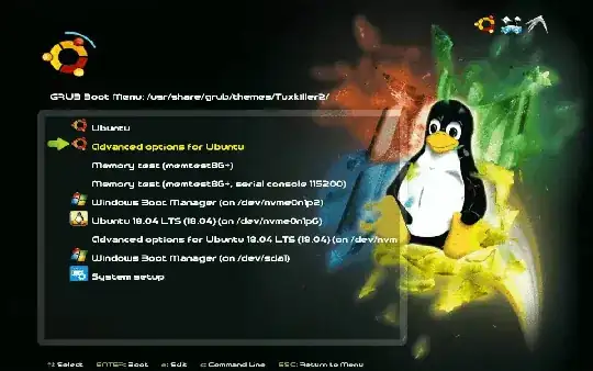

As I posted in comment you can have the terminal box open but it will be blank. If you are booting a previous kernel version Grub automatically prints a message saying what version is loading:
If you are booting the newest kernel version the terminal box stays blank. To get around this limitation see this answer: Grub theme terminal-box appearing, why?
Shockingly the most pleasing grub themed boot is with Windows 10. The grub theme stays ~98% intact and Windows 10 draws a tiny pizza spinner on the screen which stays there until Windows User Signin screen appears. With Linux the terminal box will stay up until Kernel boot messages start spamming a plain text console.
