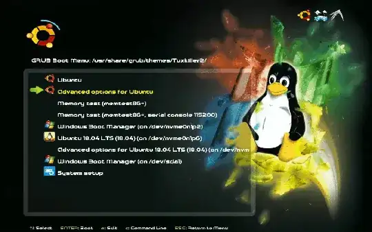

It's perfectly normal for the black text box to appear empty. Sometimes it will show the "Loading" kernel version though:
The purpose of the box is to show terminal messages before the kernel boots and mounts it's own screen with scrolling list of kernel messages.
In this example the "black box" background image was created as cut-out image of the main screen to make it less distracting.
