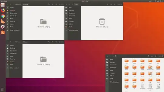

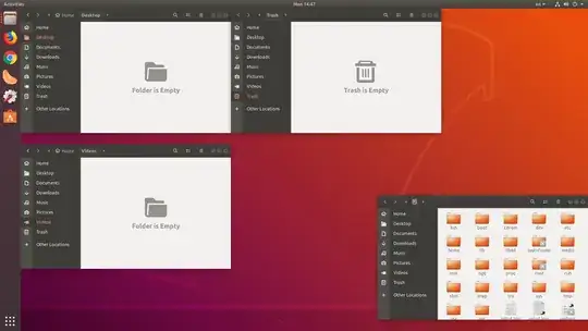

Ever since I started using Bionic, I've had the following issue with two desktops connected to HiDPI monitors (3840x2160), at work and at home: if I lock the screen and step away for some time, when I get back some windows are resized/shrinked.
It happens for applications like Nautilus and Evince, but not for others like Firefox or Texmaker. See before: Before resize and after: After resize
Subsequent lock and login cycles shrink the windows further, so that if I'd forgotten an open folder in the morning, by next day Nautilus opens by default to a really small window.
