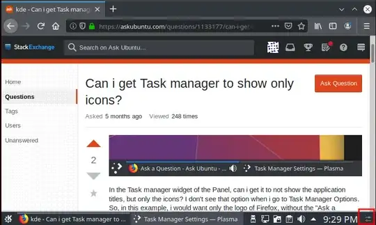

To have only icons instead of icons plus text, first click on the icon boxed in the lower right corner of the image below. (The icon may appear as three parallel bars ☰.) Clicking this icon brings up an interface that allows you to change the location and dimensions of your panel as well as to add/remove widgets.
(I should mention that you'll see the ☰ icon only if you've not locked your widgets. If you don't see the ☰ icon, that means you've locked your widgets and so can't add or remove widgets, or alter the state of your panel(s). Anyway, you can easily toggle between having your widgets locked or unlocked by pressing Alt+D and then pressing L but this has to be done directly on the desktop and not over any window that is in focus.)
Icon to allow customizing your panel & for adding widgets

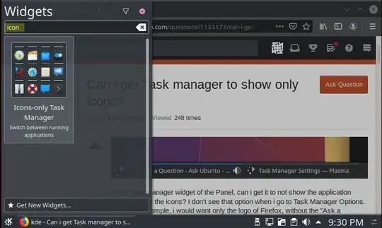

Next, click on Add Widgets and, in the search box of the window that appears, type icon, or just scroll up/down until you see the appropriate widget:
Add Widgets window with icons-only task manager
Double-click1 on the widget and then close the Add Widgets window. You'll now see both the conventional task manager (showing icons plus text) as well as the icons-only task manager (boxed in yellow) in the image below.
Remove the icons + text task manager

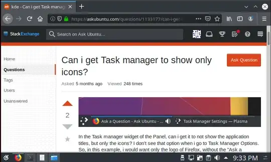

To remove the conventional task manager (showing icons plus text), again click on the the icon that allows you to configure your panel and add widgets. Hover over the area of the conventional task manager and choose Remove. Then, hover over the the icons-only task manager area and drag the task manager to where you want it.
In the image below, we have Firefox, Konsole, Kate and Dolphin all as icons only.
Icons-only task manager
