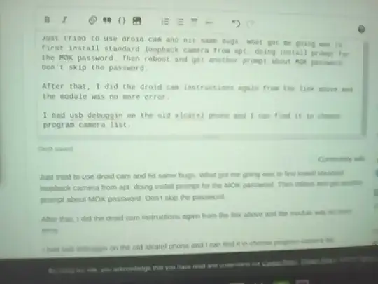

Just tried to use droid cam and hit same bugs. What got me going was to first install standard loopback camera from apt.
sudo apt install v4l2loopback-utils
doing install prompt for the MOK password. Then reboot and get another prompt about MOK password. Don't skip the password.
After that, I did the droid cam instructions again from the link above and the module was no more error.
I had usb debuggin on the old alcatel phone and I can find it in cheese program camera list. Here is the firs picture.
