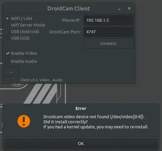

After that I tried to run the software via terminal but got the following error prompt:
error prompt
I think the error has something to do with the UEFI secure boot.
When I do lsmod | grep v4l2loopback_dc I don't get any output, indicating that Droidcam isn't really installed.
Can someone please help me with the installation?
