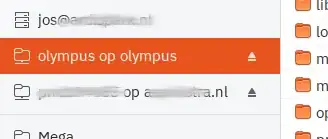

In the Files app, you have a sidebar on the left. You will see a little triangle next to the mounted device.
Click on it, and your drive will be unmounted (a.k.a. "ejected").
If you have chosen to see mounted drives on the desktop, you will have a right-click option "Eject" there as well.
